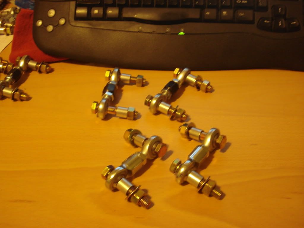

Are you going to shorted the rod ends?
How much adjustability will there be?
Will they be opposite threaded on each end?
The rod ends do have to be shortened for both front and rear links. The rear links are opposite thread and will have a minimum length of just under 2.25" and maximum length of ~2.625". The front links are very short and cannot be made with an adjusting nut like the rears. The will have slightly greater adjustability, but one end will have to be unbolted to make an adjustment.

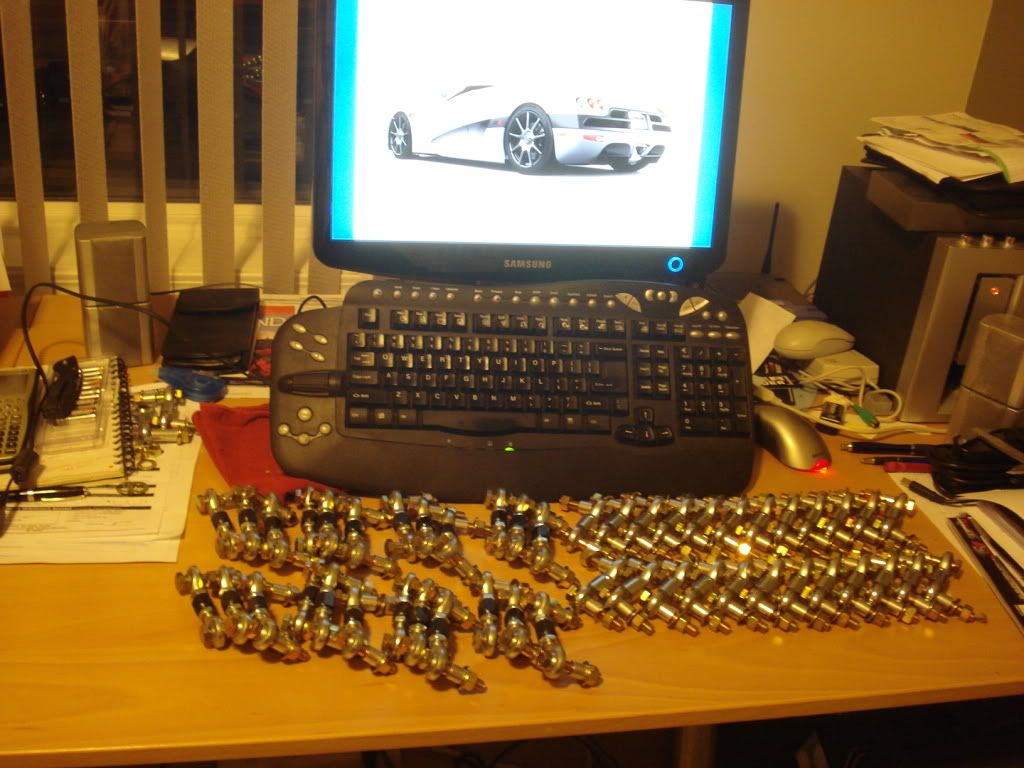

Well after about 30 laborious hours of sweat and toil over the past 4 days or so...here they are. Done.
The only thing I think may be an issue is the spacer seating directly against the control arm/sway bar end so I think I will pick up 100 more washers and toss in some extras. I will grab my spare control arm and TTL and post some pictures of fitment tomorrow. I"m not going to put mine on my daily driver just yet as I have a slough of suspension parts coming in for the big, all out suspension rebuild which is coming soon to a worklog near you.
I will pick up the boxes tomorrow and hopefully have them shipped out by Thursday evening.
