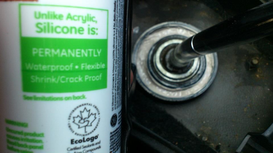

that's kind of what i did, i just did it WAYYYY more ghetto lol
May 04 2013, 1:27 AM
Post Re: Anti-Drop Shifter Bracket for 5-speed cars
Personally I hate silicone. I think it's the most over rated crap on the market. I highly recommend finding a good two part rubber system however a lot of people have commented on using JB weld to repair stuff like engine mounts. I've just never heard any comments 6 months later to hear if it's holding up ok.
