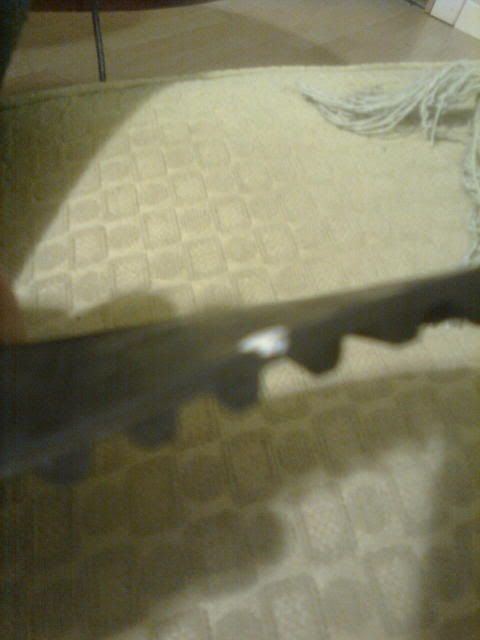

Alrighty, the GF and I devised a scheme to get the timing belt exactly on the first time every time, because nobody likes re-compressing the HTBT.
Set up all three gears where they should be if you were doing this normally. Link.
Get your new timing belt, and a marker of some sort. I favour whiteout with a brush.
Now, make a dot on the edge, not on a tooth, but between two teeth, what I will call a hole.
Like so:
Now count the holes. Don't count the one you just marked, the next one CW to it is #1. Start over on each mark.
The key list:
-Mark your first hole.
-Starting counting over, make a mark on the 10th hole.
-Starting over, make another mark on the 2nd hole.
-Starting over, the 56th hole.
-Starting over, the 70th hole.
-Starting over, the 54th hole should have your first mark.
These marks match up with the little dots on the cam gears (3 close dots are the right head gear), and one mark should line up exactly with the bottom of the crank gear. (180º from the alignment mark, maybe a little to the right, as in 170º CW)
Line up the gears to the belt, and let your tensioner go with confidence.
Spin the crank over 720º, and the factory timing marks will be dead on. Say "Thank you, Tiffany and Ryan" in your head, and proceed with reassembly :D

Hi guys, I tried this method today and I found a little problem at the crank gear.
At 180º from the alignment mark there is no tooth to match the paint, is a "hole", so you can put the painted mark in front or behind it, around 170º or 190º, but never at 180º from the alignment mark on the top of the gear.
I had to align the painted dot of the belt to the right, on the tooth around 170º clockwise to get a perfect timing.
If you try it you will see what I mean.
Could be because the ZE´s crank gear is different?. On mine the timing mark (or notch) is on a tooth, maybe on the K8 the mark is between teeth, in that case the method should work fine.
Taking this consideration, this method is very usefull, thanks a lot!
